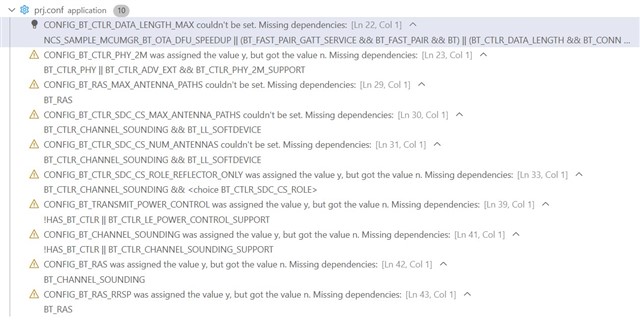

Observations: When opening the built prj.conf file, I notice several missing dependencies (see attachment).
**Questions:**
Main question:  How to get rid of those missing dependencies ?

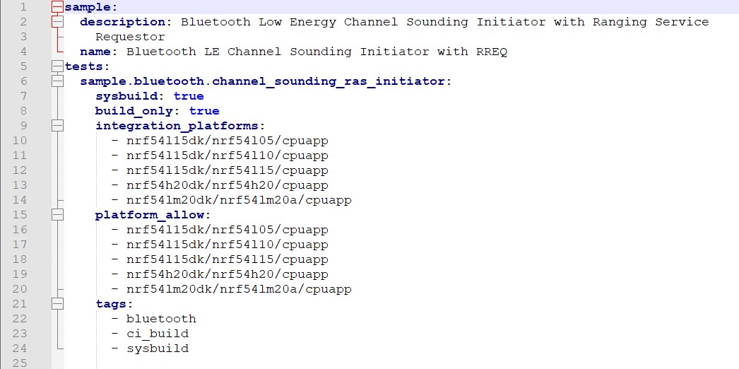

3. Regarding `sample.yaml` (see attachment) in the application root: What is its purpose? Should it be modified to include custom boards?

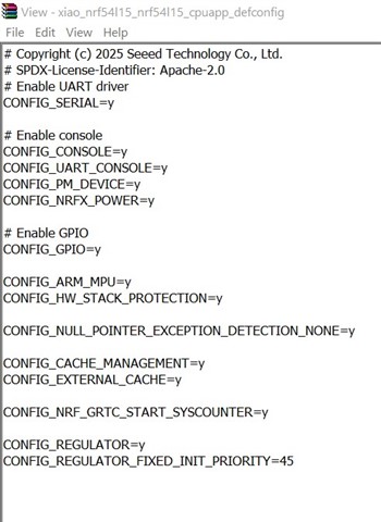

    On the warnings there I see it needs softdevice. I assume this board comes with an additional config file which makes you enable maybe the zephyr BLE controller instead of the nordic softdevice (SDC). Looking at the build logs I see it uses a xiao_nrf54l15_nrf54l15_cpuapp_defconfig, could you check what that contains?
    Basic info about the sample, supported boards, etc.

  • Hi Elfving, thanks a lot for such quick response. I also suspected the issue could be related to some misconfiguration on the soft device controller. I could not find where the SDC is configured but looking at the final ".config" file (attached in the zip file) I see this line has been added: "CONFIG_BT_LL_SOFTDEVICE=y", so I think the SDC is enabled indeed.
    I attach the xiao_nrf54l15_nrf54l15_cpuapp_defconfig but apparently there is no interesting information on this file related to the problem (but I could be wrong). I built and ran the blinky sample again (now as a west workspace) and confirm the hardware is good. The LED blinks and the terminal logs the status change from the LED.
