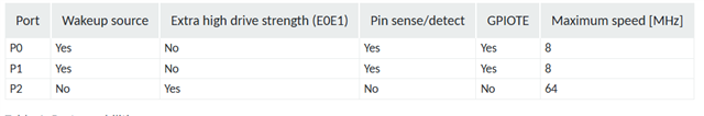

I want to Configure a UART RX pin as GPIO and use it as a Wake - up interrupt pin before going to sleep. Is this possible in nrf54l15?
I tried to do so, but I was unable to wake up from sleep through this pin.

  • You are right Varsha, sorry for missing that.
    P2 is high speed port and does not have pin sense mechanism without which wakeup conditions cannot be detected.
    If you must keep RX on P2, best is to stay in System ON idle and let the UARTE interrupt wake the CPU, or mirror the signal to a P0 or P1 pad for wake purposes. if you want SystemOff, then use another port for wakeup source.
