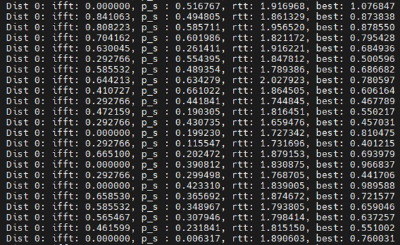

The first one, is that I'm getting some broken ifft values equal to 0, sometimes, as shown below. This issue is happening both with the dk and my custom boards.
Since the ifft should be the best measuring method, it's problematic to have some null values.

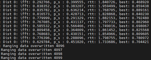

The second one is with a custom board. When I run my program for about 30-35 minutes, a warning about ranging data overwritten shows up. Therefore, it doesn't stock new values after 4096 values ? and we need to reboot if several errors appear to resume normally the measurements.
This warning doesn't show up with the dk when I run the same code and for a longer period of time as well.

    1. Can you share some more details on your testing environment here, and if you've made any specific changes to the channel sounding sample projects?
    2. Regarding the "Ranging data overwritten". You can try increasing CONFIG_BT_RAS_RRSP_RD_BUFFERS_PER_CONN to allow more rangings in one connection.

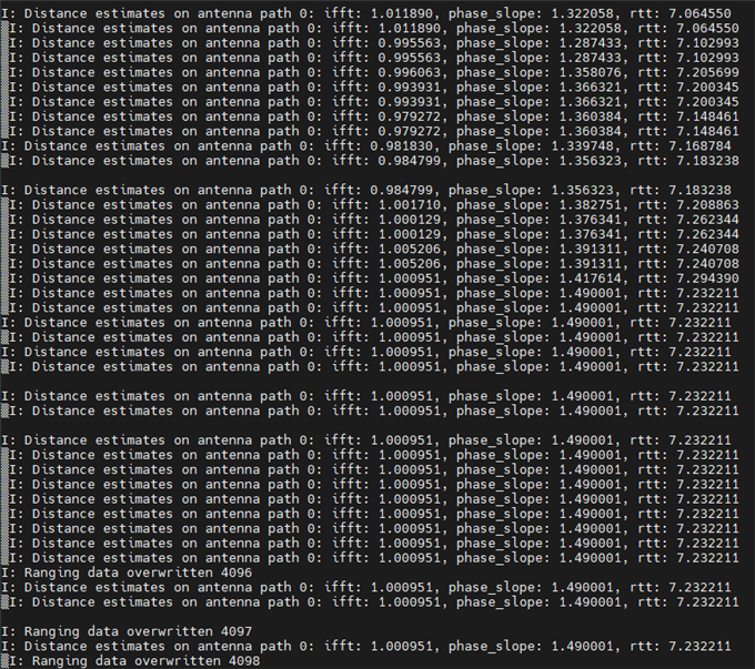

    2. I tried this option on the reflector since it's this device that has de RSSP defined. But it doesn't change anything with the default channel sounding sample, whether I put the value at 1 or 10. This picture is taken after 35 minutes of testing, the logs can be found in the attached document as well.
    Logs_CS_40min.txt
    Anyway, I'll try to modify my program so it doesn't only loop on those measurements so that I won't get this error again. Also I'm seeing that some values are doubled.

  • Hi
    I ran the Channel Sounding sample on two DKs for a few hours last night, and I don't have a single IFFT value showing 0 or any "ranging data overwritten" messages. Note that I ran the sample in NCS v3.1.1. As of NCS 3.1.0, the CONFIG_BT_CTLR_CHANNEL_SOUNDING_TEST Kconfig option was added. This option reduces the NVM usage of Channel Sounding when disabled by removing the LE CS Test and LE CS Test End HCI commands. I think this at least helps with the NVM usage and the ranging data issues.
