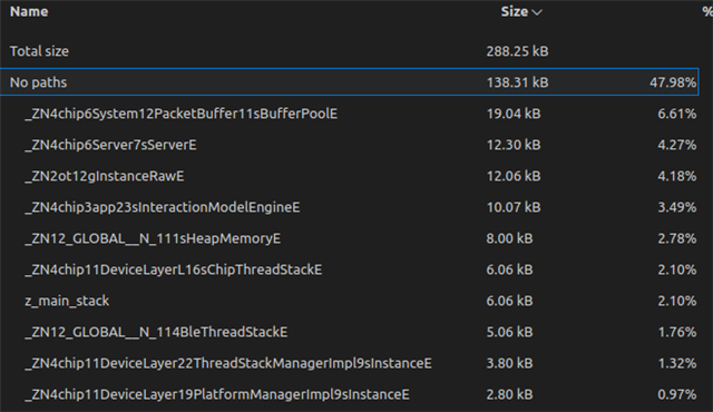

Matter subscription fails after some time causing weird state
I'm developing a Matter device based on the Window Covering sample. I have added another endpoint to the device containing some sensor clusters and it all works after commissioning. But after some time (sometimes minutes sometimes up to 20 hours). The device becomes unresponsive in Matter hubs. To debug this I used chip-tool to set up a subscription and that also works at first. But then after some time the subscription times out and after that happens the device no longer responds to chip-tool read commands with data. But what is weird is I can see in both chip-tool and device side logs that there is still communications happening. The packets still get ACK-ed. The device just fails to actually respond with data.
Here is a snippet of logs from the device:

So I have two questions here:
1. Why does the device always delete the previous subscription when I add a new one? Is this expected behaviour?
2. Why does the device become unresponsive like this?
I'm using SDK/toolchain v3.0.1 and running on a custom board with 52840 SOC.
I know you will probably ask for this so here is the important part from conf regarding Thread and Matter:
CONFIG_OPENTHREAD_NORDIC_LIBRARY_MTD=y
CONFIG_OPENTHREAD_MTD=y
CONFIG_OPENTHREAD_FTD=n
CONFIG_CHIP_ENABLE_ICD_SUPPORT=y
CONFIG_CHIP_THREAD_SSED=y
CONFIG_CHIP_ICD_IDLE_MODE_DURATION=120
CONFIG_CHIP_ICD_ACTIVE_MODE_DURATION=300
CONFIG_CHIP_ICD_SLOW_POLL_INTERVAL=1000
CONFIG_CHIP_ICD_FAST_POLLING_INTERVAL=200
I don't think the Window Cover sample unchanged had this issue and I'm sure it would be possible to go back through Git history and find where this breaks but that would take a very long time as this issue usually takes hours to appear. If you can at least point me towards something to check that would help a lot. Could this be a memory issue with the Matter thread because I did add quite a few extra clusters and attributes. I also periodically update the attribute values (am_matter_loop calls) but I don't see any of the interactions fail in the logs at least. The device recovers nicely after a reboot and resubscribe but I don't want to have to restart all the time (I could set up a watchdog to do that but come on...).

    Like you hypothesize this could be because of memory. What does the memory reports in your build log show? High percentages in that table are good indicators that the device is running out of memory. If this is the case, then make sure that you are using good practices to free up memory where possible.
    Maria
  • Hi Maria,
    Yes, I'm setting up subscriptions in interactive mode. And they do seem to work for a while. And then they randomly stop and I can't subscribe again until I restart the board.
    I have actually never tried the memory report thing before. I took a long time to generate but honestly I don't know how to read that. I will try to share it here so you can look at it and say if this looks ok.
    First the memory report that comes after compiling (that looks ok to me):
    Memory region Used Size Region Size %age Used
    FLASH: 841456 B 982528 B 85.64%
    RAM: 214861 B 256 KB 81.96%
    IDT_LIST: 0 GB 32 KB 0.00%
    And now the RAM report from the memory report tool that is a bit difficult to share here. But it does say that the total used memory is 288.25 KB which does not seem good. But I don't know how to optimize that.
    The largest buffers seem to be mostly Matter and Thread which are created by the SDK I guess. I can probably reduce Heap as I don't really use that at all. Maybe I can optimize the stack size of the threads we use (and main) but those are tiny compared to the huge buffers. Do you think this may be the issue? How does it even work at all if the memory use is so much higher than the actual RAM in the SOC. I'm not really sure how variables inside function scope work in Zephyr - are they always allocated or are the temporary variables stored in the stack? I can't really see how big the stack grows here but if the memory is already low maybe stack hits something important in RAM and that's when it breaks? Can you suggest something to debug this situation?
    Tiit
    I agree, they seem to be at an OK usage percentage.
    We have a general guide for memory footprint optimization which could be of help here.
    I need more time to look into this, but in the mean time some general debugging tips are found in Lesson 2 from the nRF Connect SDK Intermediate course.
    Maria
