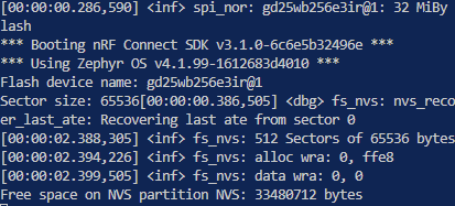

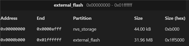

I want to use the external flash on nRF9151-DK (gd25wb256).
Having set all the necessary files (prj.conf, nrf9151dk_nrf9151_ns.overlay) and some parameters in the main.c (code below) I eventually gained access and ability to store data in flash memory using NVS. However ,I have encountered two problems:
  1. The first one was having an error (overflow of nvs_fs.sector_size) during the initialization of the NVS, which I have resolved by changing the type (uint16_t to uint32_t inside the nvs.h file - as suggested in this issue: https://github.com/zephyrproject-rtos/zephyr/issues/36590). Is there any cleaner way to get the NVS to work with this memory?
  2. I set the config to 256 sectors of 65536 bytes to get it working, but it results in only about 16MiB (16707592 bytes reported by library) of memory. However, setting the config to 512 (accordingly to the datasheet I found) results in having corrupted data (error during reading). Why is that?

    output:
    [00:00:00.428,619] <inf> spi_nor: gd25wb256e3ir@1: 32 MiBy flash
    *** Booting nRF Connect SDK v3.1.1-e2a97fe2578a ***
    *** Using Zephyr OS v4.1.99-ff8f0c579eeb ***
    Flash device name: gd25wb256e3ir@1
    Sector size: 65536[00:00:00.489,471] <dbg> fs_nvs: nvs_recover_last_ate: Recovering last ate from sector 0
    [00:00:02.482,360] <inf> fs_nvs: 256 Sectors of 65536 bytes
    [00:00:02.488,311] <inf> fs_nvs: alloc wra: 0, ffe8
    [00:00:02.493,621] <inf> fs_nvs: data wra: 0, 0
    Free space on NVS partition NVS: 16707592 bytes
    Is there any way to gain acces to whole memory using NVS? Is there any more elegant way to fix the header file (nvs.h).
    I will be grateful for any feedback, thanks!
    Michal
    can you share zephyr.dts and .config file in your build directory?
  • Thanks for the response. Files are attached below.
