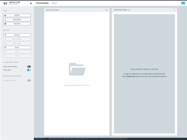

nRF54L15DK is not working after nrfjprog -e
Hi, I used nrfjprog -e to the nRF54L15DK and problem is
in Programmer

20:36:55.409	Selecting device with the serial number 001057767813
20:37:03.090	Error: Failed with exit code 1. One or more device info tasks failed: * 1057767813: Emulator error: Failed to open connection (Generic) Message: Operation device-info failed, Emulator error: Failed to open connection.
20:37:03.268	Reading readback protection status for Application core
20:37:03.269	Failed "reading readback protection status for application core". Error: code: 1, description: Generic, message: Batch task protection-get failed, Emulator error: Failed to open connection
20:37:03.308	Error: Failed with exit code 1. One or more batch tasks failed: * 1057767813: Emulator error: Failed to open connection (Generic) Message: Batch task protection-get failed, Emulator error: Failed to open connection.
20:37:09.738	Error: Failed with exit code 1. One or more device info tasks failed: * 1057767813: Timed out waiting for response from worker. (Generic) Message: Operation device-info failed, Timed out waiting for response from worker.
20:37:09.738	Selected device with the serial number 001057767813
20:37:09.738	Using nrfutil device to communicate with target via JLink
20:37:12.707	Reading readback protection status for Application core
20:37:12.707	Failed "reading readback protection status for application core". Error: code: 1, description: Generic, message: Batch task protection-get failed, Emulator error: Failed to open connection
20:37:12.760	Error: Failed with exit code 1. One or more batch tasks failed: * 1057767813: Emulator error: Failed to open connection (Generic) Message: Batch task protection-get failed, Emulator error: Failed to open connection.

2025-10-09T15:18:27.407Z ERROR Failed to initialize worker: Timed out waiting for response from worker.
2025-10-09T15:18:31.590Z ERROR Trace channel disconnected unexpectedly.
2025-10-09T15:18:31.590Z ERROR Worker terminated by signal 9.
2025-10-09T15:18:31.591Z ERROR Error output of terminated worker:

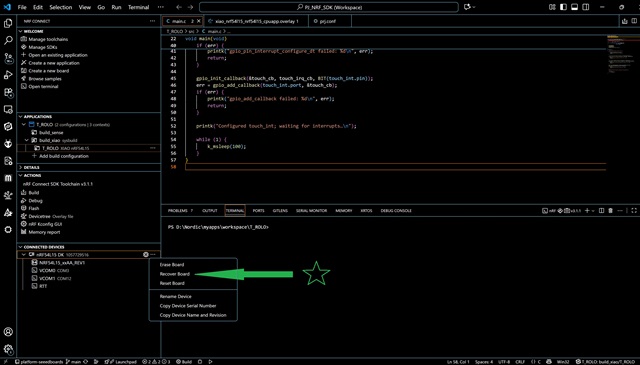

How to recover nRF54L15DK
does we need to update the nRF5340 JLink debugger?
