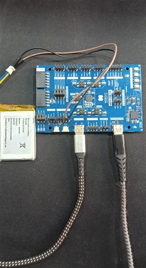

  • I have tested  using the nPM1300 EK and configured the charger using the nRF Connect for Desktop –   nPM PowerUP application with the following parameters:
    • Charging current: 800 mA
    • Termination voltage: 4.2 V
    • Trickle/Fast charging threshold: 2.9 V
    • Charging termination: 10% (default)
    I also tested both configurations — with and without a 10 kΩ NTC thermistor .
    The setup was powered using a 5 V adapter. During charging, the VBUS voltage is around 4.9 V, and after charging completes, it stabilizes at 5.0 V. The battery used is a Li-ion (3.7 V nominal, 950 mAh).
    In both cases, the charging still completes around 4.13 V, instead of reaching the expected 4.2 V termination voltage.

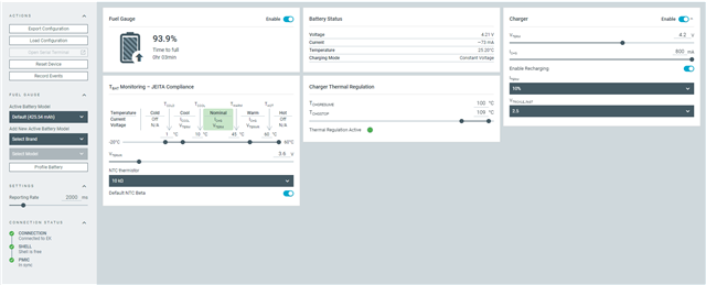

    In nPM PowerUP what does the battery status show? Does it go to constant voltage mode and what is the indicated battery voltage?
    This is with nPM1300-EK and nPM PowerUP with the same settings you mentioned. Once the 4.2V is reached, the charger enters constant voltage mode and the charging current slowly drops from the set 800mA (in this case it has dropped to 550mA).
    Thanks.

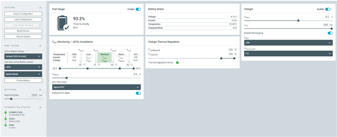

    Here are the screenshots from nPM PowerUP showing the battery status during and after charging with the nPM1300-EK.
    • During charging, the battery voltage gradually rises until it reaches 4.2 V, and the charger enters constant voltage (CV) mode.
    • In CV mode, the charging current slowly decreases from the set 800 mA (in this case, it dropped to around 73 mA) as the battery approaches full charge.
    • Battery charging completed (V = 4.10 V, I = 0 mA, Fuel Gauge = 93.2%)
