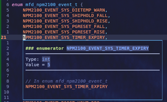

nPM2100 interrupt not triggering with general timer
I am using the nPM2100 EK dev board with a stm32wl5MOC.
Using the example from the bare metal drivers, I adapted the code to my board.
I can succesfully read and set bytes on the i2c bus to the nPM2100.
Following the example, I am only using the timer part. I set the GPIO as such:
    rslt = gpio_npm2100_config(dev, PMIC_INT_OUT_PIN, NPM2100_GPIO_MODE_IRQ_LOW, NPM2100_GPIO_CONFIG_OUTPUT | NPM2100_GPIO_CONFIG_PULLUP);
where PMIC_INT_OUT_PIN = 1.
With an oscilloscope, I see the GPIO1 goes high after the timer setup function runs. After the 3sec interval has passed, I can see the timer status goes back to idle but the GPIO1 interrupt does not generate a low pulse. I have tried different combinations of GPIO modes and config, to no avail.
Here's the entire code:

#define NPM2100_EVENT_SYS_TIMER_EXPIRY 2

        if (events & BIT(NPM2100_EVENT_SYS_TIMER_EXPIRY)) {

    rslt = mfd_npm2100_enable_events(dev, BIT(NPM2100_EVENT_SYS_TIMER_EXPIRY));
