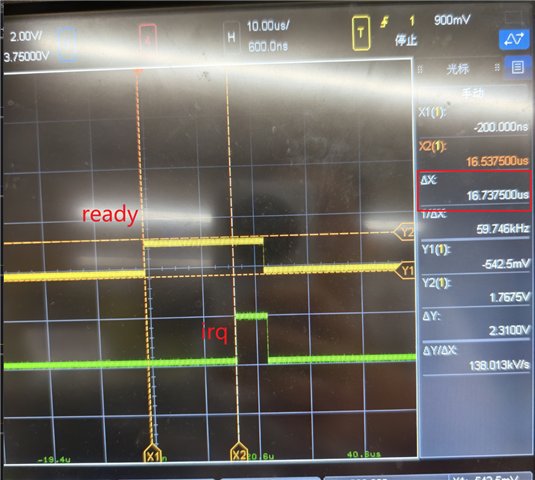

While debugging the NCS 54L15 ESB module, I observed some anomalies when measuring the radio interrupt signal. For example, after the RADIO READY event is generated, it should immediately trigger the RADIO IRQ handler. However, I measured a delay of approximately 16 microseconds between the READY signal generation and the entry into the RADIO IRQ handler. A similar delay also exists between the DISABLE signal and the RADIO IRQ handler entry. Why is this happening?(Measurement method: Using DPPI and PPIB to connect the RADIO event publish signal to GPIO task A. Immediately upon entering the RADIO IRQ handler, another pin B is set high, and the time difference between the two pins is measured.)
The following is part of my configuration:

My question is: Is this a known hardware issue, or is the RADIO IRQ being delayed by the Zephyr system scheduling, or enter sleep?
