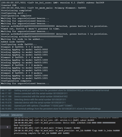

Hi Nordic team,
I am tring to make a BLE mesh net, I use two promicro(nrf52840), one for mesh_provisioner_example, one for mesh_on_off_app_example.
But mesh_provisioner_example will stuck, how can I fix this?
Due to easy debug, I add some log in code, also I remove OOB in mesh_on_off_app_example

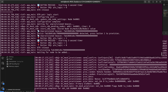

Here is node log(mesh_on_off_app_example),machine still alive.

Here is provisioner log, this machine is stuck here.

✅ prov_complete callback! net_idx=0x0000, addr=0x0001
   Setting node_addr from prov_complete
Using stored CDB
[00:00:00.175,170] <inf> bt_mesh_main: Primary Element: 0x0001
[00:00:00.175,201] <dbg> bt_mesh_main: bt_mesh_provision: net_idx 0x0000 flags 0x00 iv_index 0x0000
Using stored settings
📡 Unprovisioned beacon: fab10601d6c700000000000000000000
📍 Button IRQ: pin_logic = 1
⬇️  BUTTON PRESSED - Starting 5-second timer
📍 Button IRQ: pin_logic = 0
BTN release
BTN pair logic start
Waiting for unprovisioned beacon...
Device fab10601d6c700000000000000000000 detected, starting provisioning...
[00:00:06.312,469] <dbg> bt_mesh_provisioner: link_open: Provisioning 00000000-0000-0000-0000-c7d60106b1fa
Provisioning in progress... waiting for completion signal.
[00:00:06.382,080] <dbg> bt_mesh_provisioner: send_invite:
[00:00:07.114,624] <dbg> bt_mesh_provisioner: prov_capabilities: Elements:          4
[00:00:07.114,654] <dbg> bt_mesh_provisioner: prov_capabilities: Algorithms:        0x03
[00:00:07.114,654] <dbg> bt_mesh_provisioner: prov_capabilities: Public Key Type:   0x00
[00:00:07.114,685] <dbg> bt_mesh_provisioner: prov_capabilities: Static OOB Type:   0x00
[00:00:07.114,685] <dbg> bt_mesh_provisioner: prov_capabilities: Output OOB Size:   0
[00:00:07.114,715] <dbg> bt_mesh_provisioner: prov_capabilities: Output OOB Action: 0x0000
[00:00:07.114,746] <dbg> bt_mesh_provisioner: prov_capabilities: Input OOB Size:    0
[00:00:07.114,746] <dbg> bt_mesh_provisioner: prov_capabilities: Input OOB Action:  0x0000
[00:00:07.114,776] <dbg> bt_mesh_provisioner: send_start:
[00:00:07.828,338] <dbg> bt_mesh_provisioner: send_pub_key: Local Public Key: cefe4522223ebb1a9c1b110ae021a5d94d06cfa327b880b
[00:00:08.205,261] <dbg> bt_mesh_provisioner: prov_pub_key: Remote Public Key: 27dcacf75cd701006dcabe49b24f7bfe6f10b6cb8d352d
[00:00:08.233,459] <dbg> bt_mesh_provisioner: prov_dh_key_gen: DHkey: 0bc7864542365a5cfb003e6cf616b895cae3616f3fbcf9b64a4a0bc
[00:00:08.233,520] <dbg> bt_mesh_provisioner: send_confirm: ConfInputs[0]   0004000300000000000000000100000000cefe4522223ebb5
[00:00:08.233,581] <dbg> bt_mesh_provisioner: send_confirm: ConfInputs[32]  d94d06cfa327b88094e22757b59b07c5198d8d7d4bad5cf11
[00:00:08.233,642] <dbg> bt_mesh_provisioner: send_confirm: ConfInputs[64]  20938fac91c768ac7b22b54e95b0aa62fb27dcacf75cd701b
[00:00:08.233,734] <dbg> bt_mesh_provisioner: send_confirm: ConfInputs[96]  fe6f10b6cb8d352713d84ea9201514541f2dfc92f9b6d49ff
[00:00:08.233,795] <dbg> bt_mesh_provisioner: send_confirm: ConfInputs[128] b9a30ae5846f702c5f8ea2345d3246ad0d
[00:00:08.234,405] <dbg> bt_mesh_provisioner: send_confirm: ConfirmationSalt: fdf1c74eacb17beb325dbbf9b7dbf24d97386d569c2410d
[00:00:08.234,497] <dbg> bt_mesh_provisioner: send_confirm: AuthValue  000000000000000000000000000000000000000000000000000000
[00:00:08.235,626] <dbg> bt_mesh_provisioner: send_confirm: ConfirmationKey: f1bace7116e868b7a32f31a94c21aed2d24c51b8ee22fb9f
[00:00:08.235,900] <dbg> bt_mesh_provisioner: send_confirm: LocalRandom: b7e2d87da92fc4bb7a7a3b42f6004ec40af45e06f09b5377333f
[00:00:09.148,010] <dbg> bt_mesh_provisioner: prov_confirm: Remote Confirm: 8c966f4c2baeffcbf46dc9a097bc5546ebedcb9b937719f8a
[00:00:10.101,715] <dbg> bt_mesh_provisioner: prov_random: Remote Random: 1030ac8f4ea74114b1b80aa0a3a320e2a1c98fc9dc7a7ec4e18
[00:00:10.102,844] <dbg> bt_mesh_provisioner: prov_random: ProvisioningSalt: 93e0b98aa3946283ddffc7b4a552aa58
[00:00:10.104,644] <dbg> bt_mesh_provisioner: send_prov_data: Nonce: 74a69a9b5c0a1d7e1888deb1f3
[00:00:10.117,645] <dbg> bt_mesh_provisioner: send_prov_data: net_idx 0, iv_index 0x00000000, addr 0x0002
