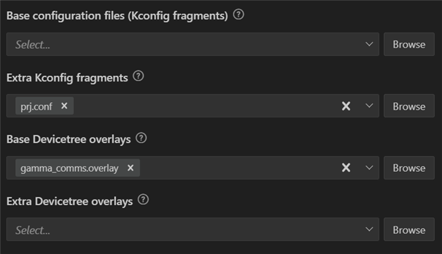

this is a bit embarrassing, I updated from nrf SDK 2.5.0 to 3.1.1 and I'm a bit lost with the simplest things.
I need to toggle an LED on a custom board. I'm using an NRF52840 on a UBLOX module. The JLINK debugger recognises the microcontroller, and the power applied is ok.
I have a prj.conf file where the GPIO is enabled:
CONFIG_GPIO=y
I have an overlay file in the "boards" subfolder inside the project with the following statements:
	leds {
		compatible = "gpio-leds";
		led0: led_0{
			gpios = < &gpio0 24 GPIO_ACTIVE_HIGH>;
			label = "LED0";
		led1: led_1{
			gpios = < &gpio1 16 GPIO_ACTIVE_HIGH>;
			label = "LED1";

  • I got it working.
    On the prj.conf file I have the two lines:
    CONFIG_GPIO=y
    CONFIG_PINCTRL=y
    On the .dts file in the "boards" folder I had to add:
    &gpiote {
    	status = "okay";
    &gpio0 {
    	status = "okay";
    &gpio1 {
    	status = "okay";
    The overlay file has the following:
    	leds {
    		led0: led_0{
    			label = "LED0";
    		led1: led_1{
    			gpios = < &gpio0 16 GPIO_ACTIVE_HIGH>;
    			label = "LED1";
