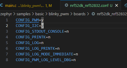

Why 'pwm_set_dt(xxx, 0)' can not set gpio floating on NCS SDK 3.0.2 ?

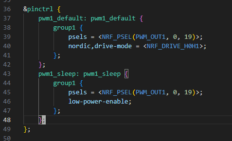

For power cost down, use dts config  to set pwm gpio H0D1 as follow:
pwm1_default: pwm1_default {
group1 {
psels = <NRF_PSEL(PWM_OUT1, 0, 26)>;
nordic,drive-mode = <NRF_DRIVE_H0D1>;
1. When on NCS 2.4.1,  pwm func 'pwm_set_dt(xxx, 0)' can set gpio floating

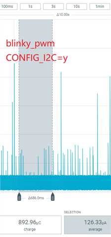

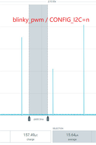

2. When on NCS 3.0.2, 'pwm_set_dt(xxx, 0)' can NOT set gpio floating, because current get up 50 uA !
How can I use  'pwm_set_dt(xxx, 0)' set pwm gpio floating ?  and get current cost down?
