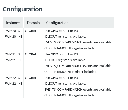

I’m currently exploring peripheral support on the nRF54L15 and nRF54LM20A series controllers. I need to turn an LED on and off using the PWM component. The LED is connected to pin P2.0. Please help me with the overlay creation and a sample code snippet. I tried using the Zephyr PWM example, but the configuration is failing.
&pinctrl {
    pwm21_default: pwm21_default {
        group1 {
            psels = <NRF_PSEL(PWM_OUT0, 2, 0)>; // Use P2.0
&pwm21 {
    compatible = "nordic,nrf-pwm";
    status = "okay";
    pinctrl-0 = <&pwm21_default>;
    pinctrl-names = "default";
/* Include headers */
#include <zephyr/kernel.h>
#include <zephyr/drivers/pwm.h>
#define PWM_PERIOD  100
#define PWM_STEP    10
#define DIRECTION_FORWARD  0
#define DIRECTION_BACKWARD 1
const struct device *dev_pwm;
int cycle = 0;
int direction = DIRECTION_FORWARD;
    int ret;
    dev_pwm = DEVICE_DT_GET(DT_NODELABEL(pwm21));
    while (true) {
        pwm_pin_set_usec(dev_pwm, 31, PWM_PERIOD, cycle, 0);
        if (direction == DIRECTION_FORWARD) {
            if (cycle < PWM_PERIOD) {
                cycle += PWM_STEP;
            } else {
                direction = DIRECTION_BACKWARD;
        } else {
            if (cycle > 0) {
                cycle -= PWM_STEP;
            } else {
        k_sleep(K_MSEC(PWM_PERIOD));
    return 0;
