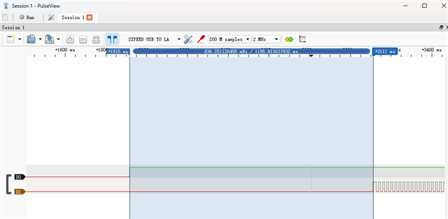

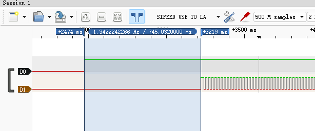

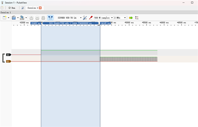

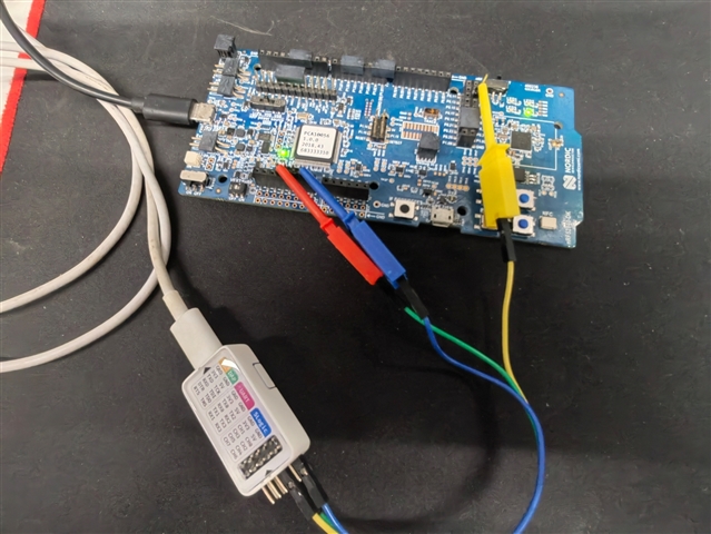

I've noticed that when using MCUBoot+External Flash+OpenThread+FOTA over BLE+PWM, the program startup time is extremely long, reaching 1684 milliseconds. As shown in the figure:D0 is VCC, and D1 is the main function executing PWM.
