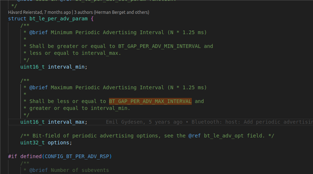

static const struct bt_le_per_adv_param per_adv_params = {
    .interval_min = 0x5280,
    .interval_max = 0x5280,
    .options = 0,
    .num_subevents = NUM_SUBEVENTS,
    .subevent_interval = SUBEVENT_INTERVAL,
    .response_slot_delay = 0x5,
    .response_slot_spacing = 0xA0,
    .num_response_slots = NUM_RSP_SLOTS,

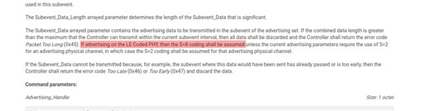

After making these changes, I found that when starting to run, the periodic advertising operates normally. However, once the extended advertising begins, the periodic advertising stops running, and only the extended advertising continues to operate normally. Why is this happening?

  • In the request_cb, I put only one piece of data into bt_le_per_adv_set_subevent_data each time, without combining multiple data entries. So 140 bytes per entry should be sufficient. When using the 2M rate, storing data this way works fine.
    so,Does this mean the controller is using S=8 coding, and the encoded data length exceeds the specified limit?
