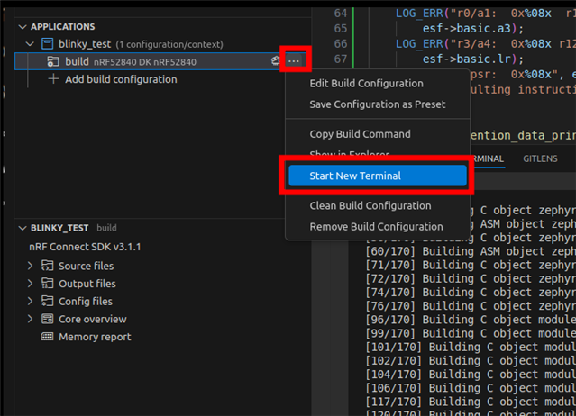

    I do think it's worth trying with nrfjprog. I doesn't look like it's using the temp folder for any temporary storage, maybe that will make a difference. You can do this by opening the terminal from VS code in your project as shown below (this ensures the toolchain environment and everything else needed to build project is set):
    Then run the following command to flash the device with the "nrfjprog" runner instead of "jlink" which seems to be the default for the board you are targeting:
    west flash --runner nrfjprog
