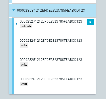

Can't get nrfConnect to recognize a custom uuid
I changed the file, C:\Users\kruenheck\AppData\Roaming\nrfconnect-bluetooth-low-energy\uuid_definitions.json so that it has a new service:

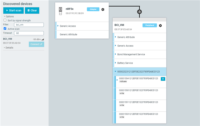

But when I look at my device in nrfConnect, it shows the uuid number but not the name
What am I missing?
