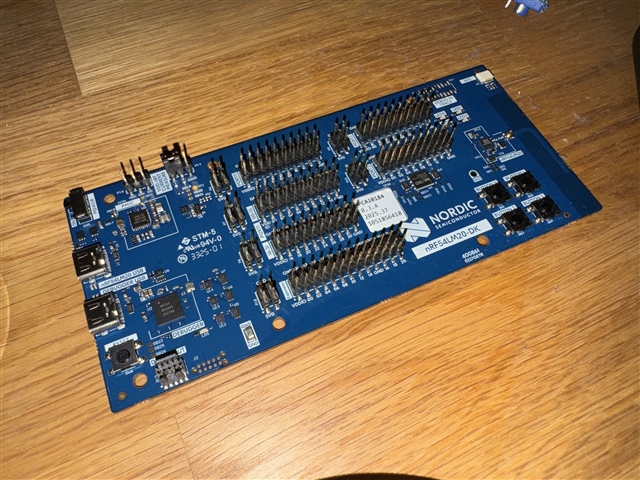

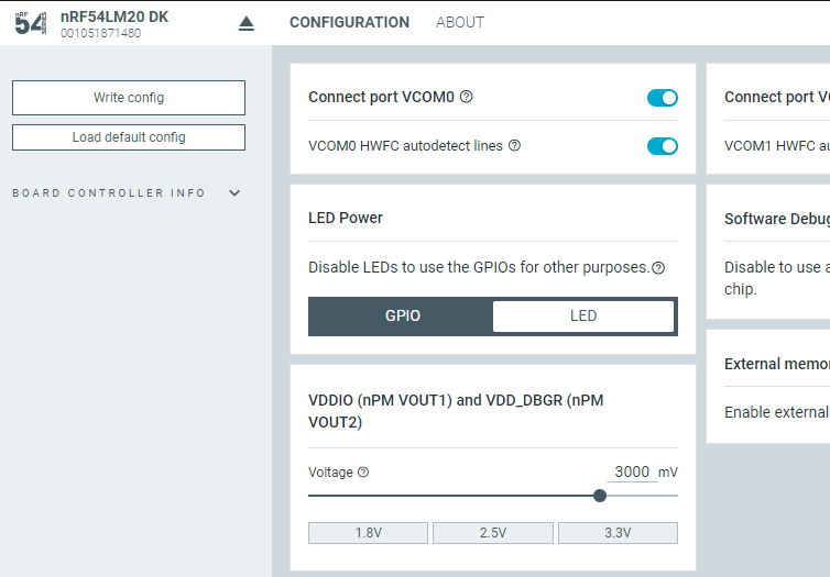

It seems like the nRF54LM20-DK is not properly powering LED 0-3. After measuring 0V from TP1 to GND, I opened the board configurator and tried applying "ledcontrol" as both off and on, and either way I'm getting no power. Any insight here would be appreciated!
PCA10184
DK Hardware Revision: 0.3.4
Board Controller FW version: 1.2.1

, then the LSOUT2 turns on, P5V0:LED gets voltage, and LEDs turn on.
