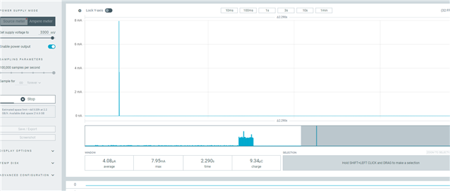

I tested uart30 of NCS3.1.1, and found that I could not enter the low power consumption mode.But there is nothing wrong with uart20.
Related code usage:
prj.conf     CONFIG_PM_DEVICE=y
       err = pm_device_action_run(uart_dev, PM_DEVICE_ACTION_SUSPEND);
        if (err) {
            LOG_ERR("Failed to suspend UART: %d", err);
Using the same code, enter the low power consumption mode, uart20 is 3uA, and uart 30 exceeds 100ua.
After canceling the log printing, the power consumption returns to normal. Is this a software defect of uart30?
Annotation print function, the power consumption returns to normal.
I guess printing will block uart30 from entering low power consumption mode.
If so, how to change it?
