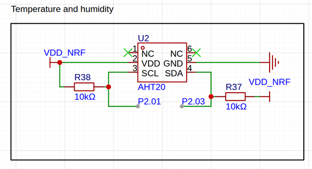

I have a quick question about configure i2c.
I have the following schematic:
And the following configuration for the nrf54l15:
&pinctrl {
i2c20_default: i2c20_default {
group1 {
psels = <NRF_PSEL(TWIM_SCL, 2, 1)>, <NRF_PSEL(TWIM_SDA, 2, 3)>;
bias-pull-up;
i2c20_sleep: i2c20_sleep {
group1 {
low-power-enable;
&i2c20 {
status = "okay";
clock-frequency = <I2C_BITRATE_STANDARD>;
pinctrl-0 = <&i2c20_default>;
pinctrl-1 = <&i2c20_sleep>;
aht20@38 {
compatible = "aosong,aht20";
reg = <0x38>;
label = "AHT20";
And the following in prj.conf:
CONFIG_I2C=y
CONFIG_SENSOR=y
CONFIG_DHT20=y
Question:
Is this the correct configuration for getting i2c communication up and running? Im trying to scan for i2c adresses, but can't find anything.
Or is there a problem using p2.01 and p2.03 for i2c communication?
