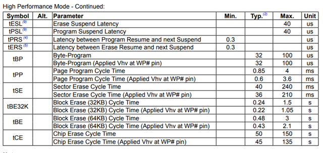

USB Mass Storage file transfert extremely slow
I have a FAT file system that I use with an USB Mass Storage feature. I use the mx25r64 NOR flash (the same as the nrf7002dk evalboard). I am working on ncs 3.0.2.
It takes around 50s to transfert a file of 1Mo.  This is extremely slow and I would like to know why.
Here is the timings of block erase and page programming of the MX25R6435F according to datasheet :
If we need to erase all bytes before writing, according to the datasheet it would take (1Mo/32kB)*0.5s = 15.6s (typical erase time is 0.2s but it is up to 1.5s so let's take 0.5s average). Programming 1Mo takes less than 1s. So between 15s and 20s is expected if we erase 1Mo before writing 1Mo. But I measured 49s
Here is the part where I configure the spi bus in my device tree :

  • Hi Benoît,
    Transferring 1 MB over USB should ideally be done in approx. ~5 seconds over the USB interface using USBD peripheral (200-300 kB/s max throughput), so I suspect that the delay is in the external flash.
    I have two test files, created with dd:
    dd if=/dev/urandom of=1mb_random_file.txt bs=1000K count=1
    dd if=/dev/zero of=1mb_file.txt bs=1000K count=1
    I consistently see a difference between the timing on these devices where all zero's will use approx. 45-46 seconds:
    pv 1mb_file.txt | dd of=/media/hkn/5961-0800/1mb_file.txt
    1000KiB 0:00:00 [95,2MiB/s] [===========================================================>] 100%
    2000+0 records in
    2000+0 records out
    1024000 bytes (1,0 MB, 1000 KiB) copied, 45,4911 s, 22,5 kB/s
    And a random pattern will use approx. 34 seconds:
    pv 1mb_random_file.txt | dd of=/media/hkn/5961-0800/1mb_file.txt
    1000KiB 0:00:05 [ 167KiB/s] [===========================================================>] 100%
    2000+0 records in
    2000+0 records out
    1024000 bytes (1,0 MB, 1000 KiB) copied, 27,5651 s, 37,1 kB/s
    So there is a dependency on writing bitwise '1' vs writing '0'.
    What you could try is to set it up in a "high performance mode":
    &mx25r64 {
    	mxicy,mx25r-power-mode = "high-performance";
    	partitions {
    		#address-cells = <1>;
    		#size-cells = <1>;
    		storage_partition: partition@0 {
    			label = "storage";
    			reg = <0x00000000 0x00100000>;
    I believe the default boot up mode is a ultra-low power mode.
    Using this high performance mode of the mx25r64, I see these numbers:
    pv 1mb_ones_file.txt | dd of=/media/hkn/5961-0800/1mb_file.txt
    1000KiB 0:00:00 [84,5MiB/s] [===========================================================>] 100%
    2000+0 records in
    2000+0 records out
    1024000 bytes (1,0 MB, 1000 KiB) copied, 15,6999 s, 65,2 kB/s
    1000KiB 0:00:00 [98,6MiB/s] [===========================================================>] 100%
    2000+0 records in
    2000+0 records out
    1024000 bytes (1,0 MB, 1000 KiB) copied, 20,7949 s, 49,2 kB/s
    Could you check if adding this mode also increases the performance to approx. 15-20 seconds at your end as well?
    Here's my test files:
    1mb_random_file.txt
    1mb_ones_file.txt
    1mb_file.txt
    Håkon
    Thank you very much for your quick and accurate answer! Indeed I see an improvement of the performance, but not as much as you.
    For the 1mb_random file : ~20s
    For the all zero file : ~30s
    It is a real improvement (regarding the 49s at the beginning), but I need to estimate the additionnal current consumption to know if this tradeoff is acceptable.
    Do you have improved speed when setting CONFIG_MASS_STORAGE_STACK_SIZE to at least 5000?
    Thank you very much for your help
    Best regards
  • Hi Benoît,
    Glad to hear that you see an improvement as well.
