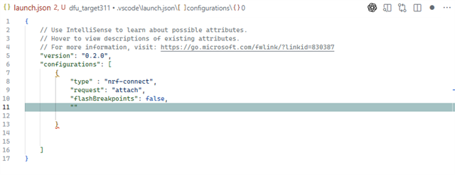

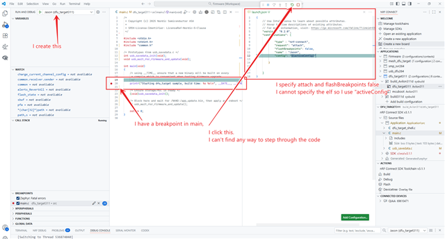

I believe I need to flash the merged.hex, then use "attach" to debug, and I need to specify "flash breakpoints" = false, and I need to supply the path to my elf file. But when I try to edit the vscode launch.json, I cannot see a way to make the configuration with these 3 things.
There is no way to specify the elf file if I specify "attach"
Is there any info on how to proceed?

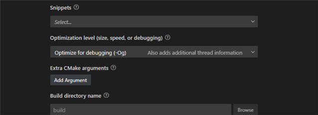

    Have you build your application with -Og ?

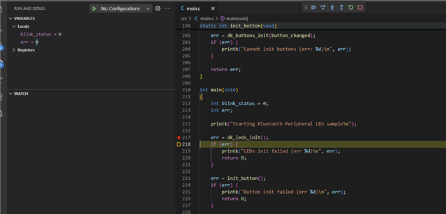

    I did a quick test here and can debug an application (attached) with MCUBoot included.
    Please check if you can debug this application (NCS v3.1.0)
