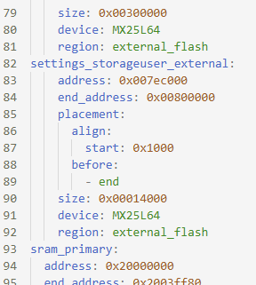

Now I would like to have this space on the external flash (which is correctly setup and working because I use the double image update with the support image on external flash. Also the littlefs is built inside the external flash). In order to do this, I add a similar partition to the external flash (settings_storageuser_external) and I replace it to the one built in the internal flash:

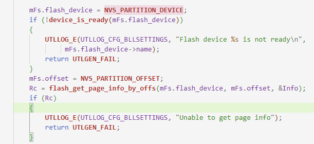

In doing so, however, the macro FIXED_PARTITION_OFFSET seems to fail:
It must be noted that FIXED_PARTITION_DEVICE does not fail. Also, if I set NVS_PARTITION_OFFSET to a fixed value instead of invoking the macro the project compiles (not sure it works as expected though, I did not try):

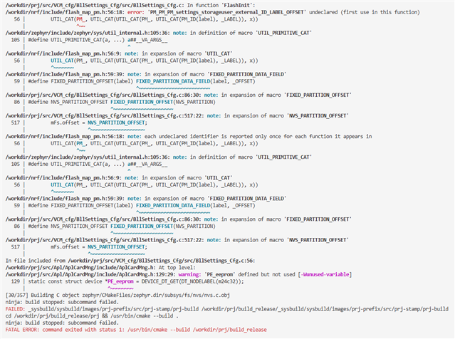

    Thank you for your answer. Cancelling the build directory did not help (I had used the "pristine build" option anyway). Here is the build log (I only cancelled the names of our modules):

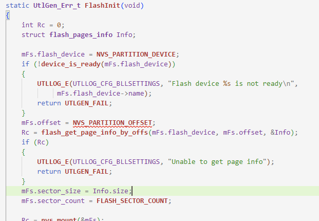

    Where FlashInit is the function where the macro I showed you before is invoked:
    As you can see NVS_PARTITION_OFFSET is undefined, while NVS_PARTITION_DEVICE is not.

    I took the zephyr/samples/subsys/nvs sample as a starting point, and added this overlay:
    &mx25r64 {
    	status = "okay";
    	chosen {
    		nordic,pm-ext-flash = &mx25r64;
    Added pm_static.yml file:
    settings_storageuser:
      address: 0x0
      end_address: 0x100000
      placement:
        align:
          start: 0x1000
      region: external_flash
    Added boards/nrf52840dk_nrf52840.conf:
    # Need this when storage is on flash
    # Need this when storage is on MX25R64
    CONFIG_NORDIC_QSPI_NOR=y
    CONFIG_NORDIC_QSPI_NOR_FLASH_LAYOUT_PAGE_SIZE=4096
    And lastly, changed the main.c to use settings_storageuser:
    #define NVS_PARTITION		settings_storageuser
    This compiled for nrf52840dk_nrf52840 board on NCS v3.0.2 at my end.
