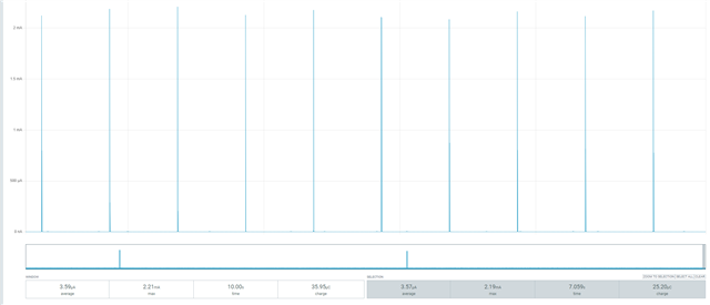

I am testing the power consumption of the npm1304 for the first time. To do this, I am using the PPK2 connected to the nPM1304-EK on VBAT and GND of the P1 connector. I have nothing connected to the Buck and LDO. I have disabled the FUEL Gauge and the Buck1 and LS/LDO outputs.
When I take my measurements, I see current spikes of 2mA every second.
Could you tell me where this consumption is coming from? Is it from the I2C communication? Is it possible to disable these consumption spikes?
