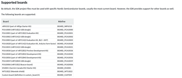

  • I'm glad to hear you were able to identify the problem, and thank you for taking the time to report back. Regarding the hex file I sent, I mistakenly built it for the PCA10040 (nRF52 DK) as I thought you were using the nRF52832 for some reason but that turned out to be fine for this basic sample.
    ( Ref. https://docs.nordicsemi.com/r/bundle/nrf5_sdk_v17.1.0/page/sdk_for_custom_boards.html)
