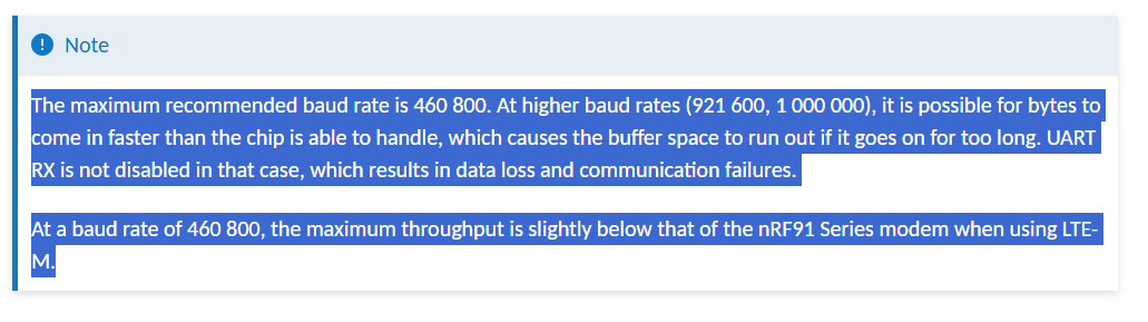

    4. The default baud rate for UART communication with the Serial LTE Modem (SLM) application is 115200 which is set in device tree.
    However, the maximum baud rate can set 460800 (nRF91 Series as a Zephyr-compatible modem).

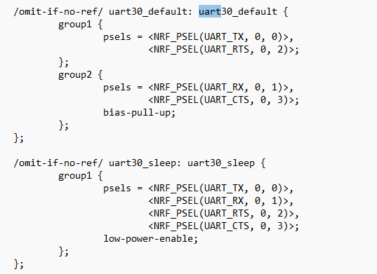

  • Hello Kazi Afroza,
    I have configured the power pin enable functionality on the SLM. After some debugging I realized the modem is not being turned on from sleep which results in no response on AT commands. However, if I manually generate an interrupt on configured SLM power pin the rest of the communication went through.
    Moreover, I have noticed that if I use custom pins for UART configuration on nrf54L15 DK instead of the default board provided UART30 config, i noticed those errors. So I'm not sure if the choice of pins for UART change the functionality somehow. Do we need to have CTS/RTS enabled for this async uart communication? What happens if we dont use hw flow control at all?

    ''Moreover, I have noticed that if I use custom pins for UART configuration on nrf54L15 DK instead of the default board provided UART30 config, i noticed those errors. ''
    UART peripheral pins are restricted on nRF54L15. Not all pins can be used for all UART instances. In the default pin setting, UART30 uses pin from P0.
     UART30 is restricted to using pins from GPIO port 0 (P0) only. Peripherals cannot mix pins from different ports, and no peripheral is able to cross over to the P0 domain from other ports. You can look at this previous case (+) Question on nRF54L15 QFN48 pin assignment - Nordic Q&A - Nordic DevZone - Nordic DevZone
