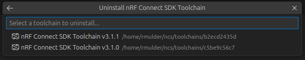

Whenever I open my workspace or build in VS Code, the Output tab of the bottom pane opens to nRF Connect output where it repeats this many times:
[west]: FATAL ERROR: can't load west manifest: Malformed manifest data
[west]: Schema file: /home/rmulder/ncs/toolchains/b2ecd2435d/usr/local/lib/python3.12/site-packages/west/manifest-schema.yml
[west]: Hint: "self: import: submanifests": file not found
[west]: exited with code 1.
How can I debug this? Which manifest file is it referring to?
  • can you try to uninstall and reinstall the toolchain using VS Code?
    I have a new computer, so I don't have all the toolchains installed, but I guess you know what toolchain you are trying to use, and you can try to re-install that one in particular.
    Edvin
  • I tried that, but no change.
    Here's my toolchain info from the Output pane:
    =========== Toolchain validation report for nRF Connect SDK Toolchain v3.1.1 ===========
    📦 Using the nRF Connect SDK v3.1.1 at /home/rmulder/devel/<project root folder name was here>
    No issues were detected with the toolchain.
