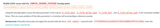

    I get: System fault:  illegal use of the EPSR

    There is a known issue related to System Viewer introduced in this SDK version which was later fixed in Zephyr:
    https://docs.nordicsemi.com/bundle/ncs-latest/page/nrf/releases_and_maturity/known_issues.html#bluetooth_le
