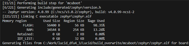

What is the best way to protect against downgrading the APP FW via DFU.
I seems that im able to downgrade even 2 config below are set.
I tested it on SDK 2.7.0 and here it was not possible to downgrade, but on latest it is
Im Using SDK 3.0.2 and 54L15
Can it be done with the config parameter, or are more needed
CONFIG_BOOT_UPGRADE_ONLY=y
CONFIG_MCUBOOT_HW_DOWNGRADE_PREVENTION=y
