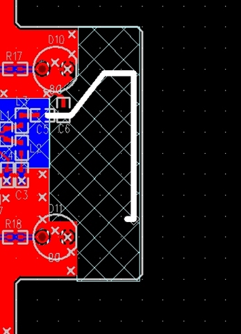

NRF24L01 basic trace antenna, load cap tuning and lenght
i get various answer about this, been in the rf design for a while, we used to make global antenna lenght on some give am ook circuit a tad shorter and then use a load cap to fine tune to get maximum performance (ie range and sensitivity)
is it valid for the NRF24L01+ at 2.4ghz ?
righ now its a mock up pcb and i did test it, it works but i get low range (ie about 30ft)
antenna trace highligthed in white is single ended connection left open at the end, and is exactly 3.125 cm, width is 0,7mm.
C6 load cap is 1pf per design guide from the data sheet.
thanks for any advice to improve range.
