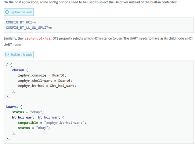

    the lte ble gateway application tells you to load the samples/bluetooth/hci_lpuart application into the nRF9160DK board with SW10 set to nRF52. I did that with the following build configuration:
    1. Board Target - nrf9160dk/nrf52840  Revision - 0.14.0
    2. Base Configuration files - prj.conf   boards/nrf9160dk_nrf52840.conf
    3. Base Devicetree Overlays - boards/nrf9160dk_nrf52840.overlay
    It builds and flashes fine but I see nothing on any of the 3 COM ports created by the nRF9160DK board on power up.

    ASSERTION FAIL [success] @ WEST_TOPDIR/zephyr/subsys/bluetooth/host/hci_core.c:432
    command opcode 0x0c03 timeout

    I am working with Timothy and I can verify that the changes you recommended for the first red line error are corrected with your two CONFIG_TFM_PROFILE_TYPE... lines but with the proviso that they are done in the nRF9160 project rather than the nRF52 project. Thanks.
