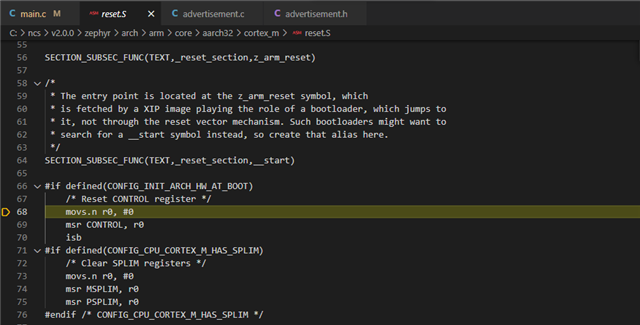

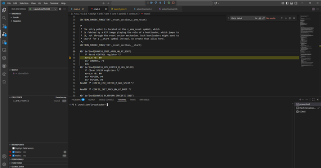

In a few cases, when trying to debug my code on either a board with an NRF52810 or an NRF52832, the debugger breaks immediately on \v2.0.0\zephyr\arch\arm\core\aarch32\cortex_m\reset.S
Trying to step over or continue just leads the debugger to hang, and it seems like the application doesn't continue to run.

    The call stack is empty, just z_arm_reset().
    I am expecting it to break on the enterance to main, before BT is enabled.
    The code breaks in the same place, even when compiling with: CONFIG_RESET_ON_FATAL_ERROR=n

    Id Target Id Frame * 1 Thread 57005 (Unknown thread) z_arm_reset () at C:/ncs/v2.0.0/zephyr/arch/arm/core/aarch32/cortex_m\reset.S:68
