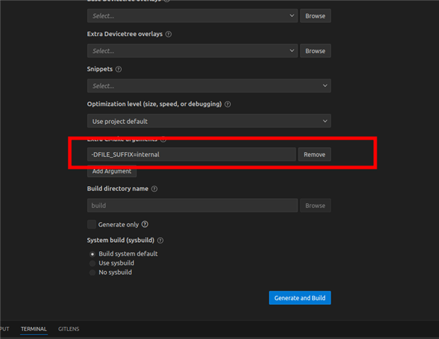

Matter light_switch: Error when generating and building: 'PM_MCUBOOT_SECONDARY_ADDRESS' undeclared here
Freshly installed VS Code natively on Windows (also tried on Linux and WSL with same result) with NRF Connect Extension Pack, SDK 3.1.1, Toolchain 3.1.1 was used to create a new application as copy of the matter/light_switch sample. Chip is XIAO NRF54L15. I did not apply any changes to the default config. I selected the xiao_nrf54l15/nrf54l15/cpuapp board from the XIAO github.
Unfortunately it fails because PM_MCUBOOT_SECONDARY_ADDRESS is not defined. Here the relevant part from the log:
