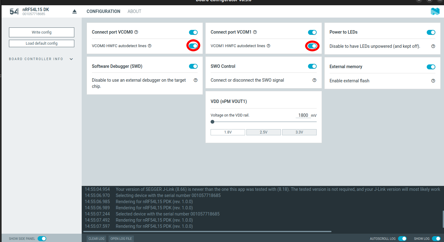

    First, please ensure you the flow control lines enabled for the USB - UART bridge. This is required as the hci_uart sample enables HW flow control by default.

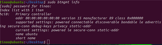

    then run sudo btattach -B /dev/ttyACM1 -S 1000000 -P h4 followed by "sudo btmgmt info" from another terminal to confirm if your new hci inferface got added.

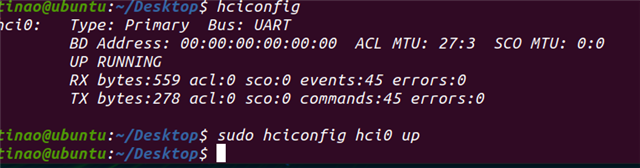

  • I was thrilled to receive your reply. I tried the method you suggested. After ensuring the flow control line was enabled for the USB-UART bridge, I reflashed the program. Running `sudo btmgmt info` displayed the information shown in the image below. It appears the configuration succeeded, but all addresses are still showing as 0. This prevents other devices from detecting the development board, making subsequent operations like establishing connections impossible. When I run ‘hciconfig’, it shows the information in the image below. Executing “sudo hciconfig hci0 up” also doesn't produce any errors. So the current issue remains: the board's address is still displayed as 0. Do you have any better suggestions? I look forward to your reply.

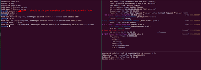

  • Please try the following commands in 'btmgmt' and see if you can get the board to start BLE advertising:
    You can use nRF connect on Android/iOS to verify that it's advertising.
    The host does not set a public address and is therefore shown as 00:00:.., but the controller will use it's default random static address.
