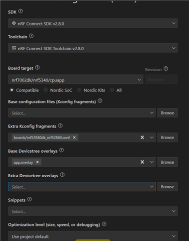

  • I tried building the modified project (sta_2) you suggested, but it threw the following build error:
    devicetree error: Label 'mx25r64' appears on /soc/peripheral@50000000/spi@8000/mx25r6435f@0 and on /soc/peripheral@50000000/spi@a000/mx25r6435f@0

  • Can you please share the build command that you used, and the entire build log (not just where it shows the first error).

  • Build log:
    Building sta_2
    west build --build-dir c:/Users/NEEVEE/Downloads/sta_2/sta_2/build c:/Users/NEEVEE/Downloads/sta_2/sta_2 --pristine --board nrf7002dk/nrf5340/cpuapp -- -DNCS_TOOLCHAIN_VERSION="NONE" -DEXTRA_CONF_FILE=boards/nrf52840dk_nrf52840.conf -DDTC_OVERLAY_FILE="app.overlay"

    I am sorry. I don't know why I didn't pick up what board you were using. I was trying testing your application for the nRF52840dk/nrf52840, which was why I changed your app.overlay and sysbuild\mcuboot.overlay.
    Attached is the updated version, with your original overlay files. Then I guess the only real change is in the sysbuild.conf, but I attached the whole thing, just in case there is anything else that I did.
