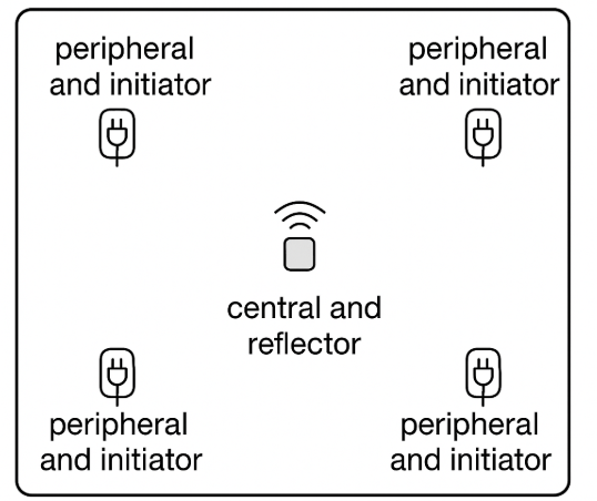

    Thank you for answer. Our plan is to use stationary (non-battery) device as Initiator, and tags (battery devices) as Reflector. I am afraid, that we can't consider an option, with using initiator on tags, because we need to store calculations on stationary devices. Moreover these measurements can affect on battery life.
    Globally, multireflector system works, but we need to reconnect to device each time and it takes a lot of time (Firstly, by intiator we connect via bluetooth to reflector, then do CS procedure, after that do distance calculations, then disconnect from reflector, then initiator repeat all steps for next reflectors).
    Our goal task, to achieve fastest measurements between one initiator and multireflectors.
  • Note that what Edvin said is you use the movable devices as reflector to save power BUT you make them the central, this as the central controls the timing so you will have a lot less collisions compared to using the movable as a peripheral. In the latter each of the static devices will set it's own scheduling and the then it is more or less guaranteed you will get scheduling conflicts. Note that if you have more than one moving device then you will also have to deal with scheduling conflicts.

    As   said, the movable devices should be reflectors to save power, but it should also be the central, to avoid scheduling conflicts. Especially when you have many initiators, trying to do channel sounding at the same time. If the reflector is in a connection with many devices, it will struggle to maintain all the connections, and even more to do successful channel sounding procedures.
    If the tag is a reflector and BLE central, it controls the connection timing.
    This figure kind of illustrates it, but it is not perfect. Just a couple of iterations through chatgpt:
