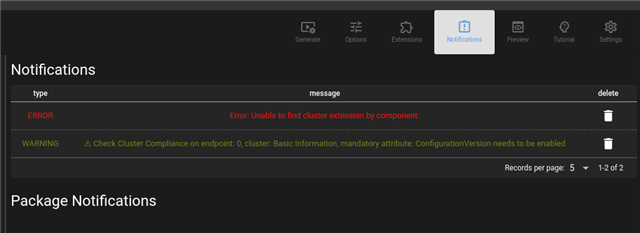

"Multiple Definition of" Error when Using Custom Commands in Manufacturer-Specific Cluster
I’m working with a Manufacturer-Specific Cluster (Attributes) in the Matter Template sample from NCS SDK v3.1.1, and it works fine with attributes. However, when I try to implement custom commands, I encounter a "multiple definition of" error.
NewCluster.xml
<?xml version="1.0" encoding="UTF-8" standalone="yes"?>
<configurator>
    <cluster>
        <domain>General</domain>
        <name>MyCluster</name>
        <code>0xFFF1FC01</code>
        <define>MY_CLUSTER</define>
        <description>The cluster showcases a cluster manufacturer extensions</description>
        <command source="client" code="0xFFF10000" name="MyCommand" optional="false">
            <description>Change LED state</description>
        </command>
        <attribute side="server" code="0xFFF10000" define="ATTR_1" type="char_string" writable="true" optional="false" default="Attribute 1">Attr1</attribute>
        <attribute side="server" code="0xFFF10001" define="ATTR_2" type="boolean" writable="true" default="0" optional="false">Attr2<description/></attribute>
        <event side="server" code="0xFFF10000" name="Event1" priority="info" optional="false">
            <description>Event 1.</description>
        </event>
    </cluster>
</configurator>
