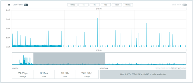

Sudden Battery Drain and Unexpected Current Spikes in nRF52832 Device (nRF5 SDK 17.0.2)
We are investigating a sudden battery drain issue in our nRF52832-based wireless product. During power profiling, we noticed unexpected current glitches (please see attached image)

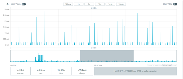

Image 1 shows power consumption in idle mode where as image 2 shows active mode to sleep mode transition.
It appear that current glitches are prevent the system from entering proper sleep mode, causing higher than expected idle current and some times faster battery depletion.

Some devices behave as expected initially. After a few BLE transmissions or wake cycles, current consumption suddenly increases to 1–2 mA continuously, and in some cases up to 3–5 mA, even when the device is supposed to be sleeping. Once this happens, the current never returns to µA-level sleep until reset. The issue is intermittent and not reproducible across all units.
As Attached screenshot of the current consumption waveform showing the irregular spikes and elevated idle current.

  • Hi Madhav,
    We have looked at this but are not able to match your description with 1-5 mA current during sleep to what we see in the plots. Can you please share plots that show more detail, and clarify at which point in which plots we see the different states (bot active state, epxected sleep state, and exessive sleep current)? It owuld also be good to use the selection tool of the power profiler so that we see the average current for these states only and can compare (so the problematic idle current compared to expected).
    That said, if the additional curent consumption was in the order of 0.3-1 mA, that could be explaind by for instance some peripherals requesting the HF clock on during sleep for some reason. When you write up to 5 mA, so you then mean peak current or average during the problematic time? The PPK is not very good at showing short peaks, so we should focus on the average current in idle.
