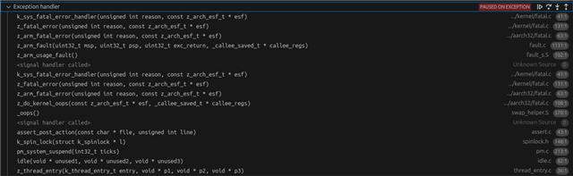

NRF52840 Fatal Error doesn't stop debugger
I`m working on a custom board. I have been playing around with it for a couple of months, but just recently stumble upon a strange behavior. This is a custom device where the NRF52840 communicates wit an NRF9160  - its using the SLM application. While debugging the NRF52840 I noticed that the debugger keeps running without stopping, however if I pause the debug session it will point me to a Fatal Error (see image attached).  What could be the meaning of this ? If eventually the system reset during the debug session it would throw a Fatal Error and could be the reason why it doesn't trigger the error automatically ? Also, as you can see from the image, the call stack doesn't help me much understating the origin of the error.
Thanks!
