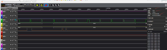

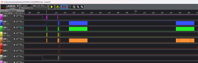

I then used a logic analyzer to capture the signals. Below are the definitions for the corresponding lines:
0:FLASH CS
1: WIFI CS
2: CLK
3. MISO
4, MOSI
5.HOST_IRQ
6.BUCK_EN
7:IO VDD EN

D: RDSR1 = 0x0Logic Analyzer I noticed that the SPI clock signal has a very short high-level duration.
