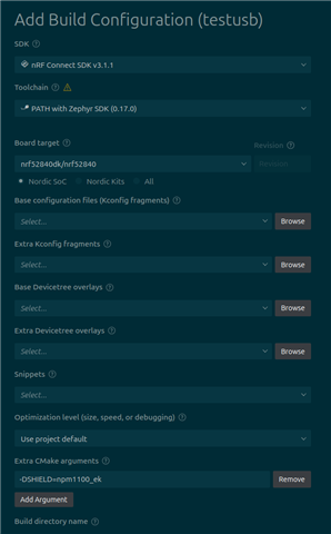

    I took the subsys/usb/testusb sample, and compiled it with the "npm1100_ek" shield:
    west build -b nrf52840dk/nrf52840 -- -DSHIELD=npm1100_ek
    Alternative is to do this in vscode:
    This shall compile out-of-the-box without any errors.
    I added a usb connection for serial communication, connected as suggested by the reference design of the npm1100
    Can you share exactly what you added/changed?
