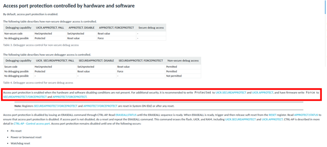

    - To me, the table at https://docs.nordicsemi.com/bundle/ps_nrf9151/page/dif.html#d425e281 is not clear. I assume now that it means for the "debugging possible" rows, all conditions must be true whereas for the "No debugging possible" rows, debugging is not possible as soon as 1 of the conditions is true. Is this correct?
    Yes correct, and I agree that this could have been made more clear. I think it's implied by the paragraph after:

  • I also have some unclarities for the APPROTECT mechanism on NRF9151.
    There is this statement in the Nordic documentation:
    On the nRF91x1 Series devices, the register setting related to the CONFIG_NRF_APPROTECT_LOCK Kconfig option does not persist in System ON IDLE mode. You must lock the UICR.APPROTECT register to enable the hardware AP-Protect mechanism as instructed in Enabling hardware AP-Protect by locking the UICR.APPROTECT register.
    As instructed in the "Enabling hardware AP-Protect by locking the UICR.APPROTECT register.",
    we must use nrfutil with this command "nrfutil device protection-set All"
    We tried this method, but it proved unusable because the nRF9151 automatically locks the device shortly after startup.
    We attempted to disable the automatic locking by setting CONFIG_NRF_APPROTECT_USER_HANDLING=y, but without success.
    It seems that the nRF9151 enables AP protection when we disable our UART with this line of code:
    pm_device_action_run(uart_dev, PM_DEVICE_ACTION_SUSPEND);
    After this line, the debugger is disabled, and we can no longer enable hardware AP protection with "nrfutil device protection-set All".
    My question is:
    How can we disable the automatic activation of the lock when the serial port is suspended (so that we can enable hardware AP protection with nrfutil)?
