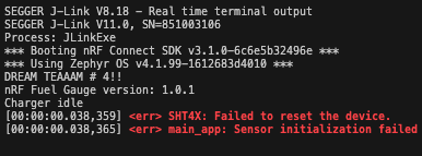

I spoke with the Nordic AI Assistant, and one of the suggestions was to add the property zephyr,deferred-init so that Zephyr doesn’t initialize the sensor at boot time. This allows me to manually initialize the device later using device_init(dev).
Now, my .dts overlay includes the following:
   sht4x: sht4x@44 {
        status = "okay";
        compatible = "sensirion,sht4x";
        reg = <0x44>;
        repeatability = <0>;
        zephyr,deferred-init;
In main(), I added:
  // Turn on sensor power
    if (!regulator_is_enabled(ldsw1))
        ret = regulator_enable(ldsw1);
    if (device_init(sht_dev) || !device_is_ready(sht_dev)) {
        LOG_ERR("Sensor initialization failed");
        return 0;
The logs show that Zephyr indeed stopped trying to initialize the sensor at boot time, as expected.
So what could be causing the issue now?
