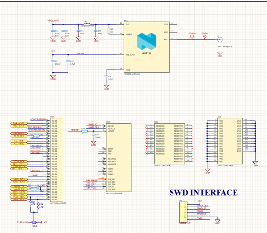

We have developed a custom PCB using nRF9151 and nPM1300.
In our setup, sometimes the PMIC powers up and works correctly, but other times it does not start at all. We are not sure what is causing this issue.

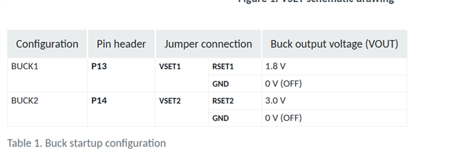

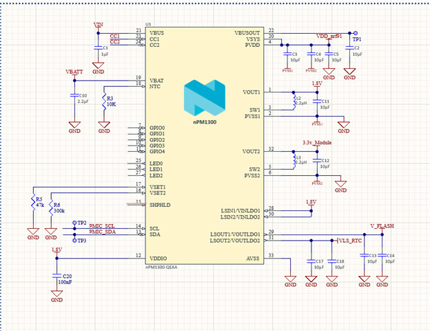

  • nPM1300 connections:
    • VSYS → connected to nRF9151 VDD
    • BUCK1 (VOUT1 = 1.8 V) → supplies nRF9151 GPIO (VDD_GPIO) and I²C pull-ups
    • BUCK2 (VOUT2 = 3.3 V) → used for other modules
    • LDO1 and LDO2 also enabled for additional 1.8 V and RTC supplies
    • I²C pull-ups: 4.7 kΩ to 1.8 V (BUCK1 output)

  • Sometimes the PMIC powers the system normally.
  • Other times, it doesn’t start unless we connect the nRF Desktop App (nRF Connect) through the debugger (SWD pins: SDIO, SCLK, RESET).
  • When connected via debugger, we can scan the PMIC over I²C and see 1.8 V output on BUCK1 and BUCK2, and both LDOs turn on as expected.
  • When running from battery only (without debugger connected), the PMIC sometimes fails to start.
Could you please help us understand why the nPM1300 is not consistently powering up the system?
Do we need any specific enable or power-up sequence between the PMIC and nRF9151?
