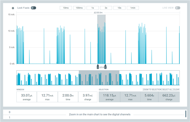

i'm working on a matter sensor on a nRF52840 Dongle and BME280.
The softaware is based on matter/temperature_sensor with config changes to support nRf52840 Dongle.
Inside config file I have:
CONFIG_PM_DEVICE=y
CONFIG_RAM_POWER_DOWN_LIBRARY=y

Thanks for your answer but i have read all those articles already.
Unfortunately i cannot use CONFIG_SERIAL=n because i'm using I2C.
Another thing that may have an impact might be CONFIG_CHIP_ICD_ACTIVE_MODE_THRESHOLD. This one is set to 5000 ms standard and we also have CONFIG_CHIP_ICD_ACTIVE_MODE_DURATION = 300 ms which goes pretty close to what i'm seeing in ppk2 graph -> those spikes for 5,6 seconds.
I have tried to set CONFIG_CHIP_ICD_ACTIVE_MODE_THRESHOLD to 2500 ms but this just breaks all communication
Please point me to some detailed docs / examples about CONFIG_CHIP_ICD_ACTIVE_MODE_THRESHOLD, CONFIG_CHIP_ICD_ACTIVE_MODE_DURATION that can explain what are they doing.
My sensor should require about 7,2 - 7,3 uA at 2Hz sampling rate but from here to 33 uA there is a lot of space for improvement.
CONFIG_SERIAL setting impact UART in this case, no impact to I2C or SPI.
What is the idle current here? Maybe you can even upload the PPK2 trace.
Kenneth
