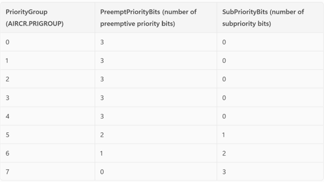

    Our team informs me that ARM Support confirms how the IRQ priority bits, three in our case, are being treated as group (preemptive) and sub-priority, based on the AIRCR.PRIGOUP setting. Image summary table below. From here, the first row, we can then gather that with PRIRGOUP at default value '0' all three bits are used as group priority bits.
    Based on this, our team were not able to map earlier findings matching the expected behavior:
    “when Timer2’s interrupt priority is set to 1, Timer0 and Timer1 interrupts cannot preempt Timer2’s ISR;
    when Timer2’s priority is changed to 2, Timer0 and Timer1 can successfully preempt it.”
    Instead, in both cases with Timer2 IRQ priority set to a non-zero value (= group priority set lower vs. Timer0 and Timer1) the Timer0 and Timer1 IRQs should be able to preempt it.
    Another thing that would impact here is the AIRCR.PRIS setting: if this set on (high) then any secure IRQs would have higher priority over non-secure IRQs.
    Can you please check AIRCR.PRIS setting, if set how are the sec/non-sec configs between Timer0/Timer1/Timer2?
    Øyvind
