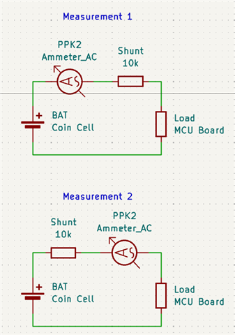

I try to use the PPK2 to measure current of a MCU in sleep. The board has some caps and a coin cell to keep the RTC on chip alive. It wakes up every 1 second to check wake up conditions.This naturally causes the a current spike. The amplitude of this spike is what i am trying to measure.

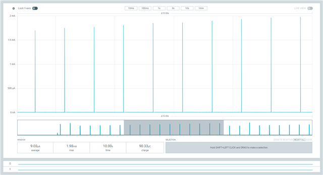

Here is where the problem comes in. The current spikes, the PPK2 measures are impossibly high. I added 10k Resistor in series before the PPK2 (amperemeter mode) to check the values using a scope. The spikes are way too high, up to 3mA.

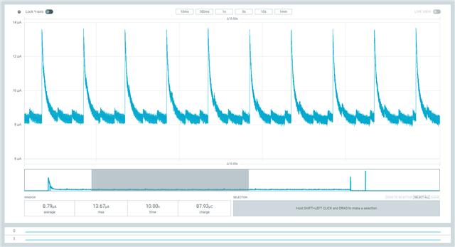

When adding the shunt in series after the PPK2 the values are reasonable: 10uA - 15uA
This should no bee the case, it looks like the PPK2 is supplying power in ampere meter mode.
Is there anything im doing wrong? Why is this?

    I can not be 100% sure, but I think the problem is with the PPK2 auto range control. When the current is small, PPK activates the large shunt resistor. Then the current suddenly rises, but PPK remains at a large shunt resistor for some time before switching to a lower value.
    PPK is not bad, but it cannot be fixed in a single range. This is a problem when the current is dynamic.
    Once again, I am not an expert for PPK, but it seems this can be an issue.
