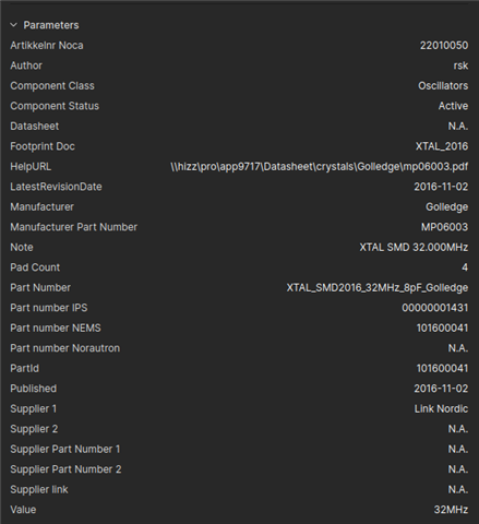

I am developing a project with the nRF54L15 and would like to obtain recommendations for specific part numbers of crystals compatible with the reference layout.
According to the nRF54L15 documentation, the reference layout specifies:
32.768 kHz Crystal (X1):
Footprint: XTAL_2012 (2 pads)
Charge capacitance: 9 pF
Tolerance: ±20 ppm
32 MHz Crystal (X2):
Footprint: XTAL_2016 (4 pads)
Charge capacitance: 8 pF
Tolerance: ±40 ppm
I would like to know:
What are the specific part numbers of crystals (manufacturer and model) that have been validated by Nordic for use with the nRF54L15?
Are there any recommended crystals that meet the specifications of the reference layout and that have already been used in reference projects? Thank you in advance for your assistance.
