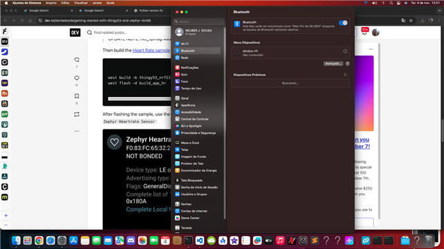

I can't access thingy53 in Mac Os Ventura to execute a neuton-nordic-thingy53-ble-remotecontrol project using Bluetooth 4.0 Orico bt-403 dongle adapter
https://github.com/Neuton-tinyML/neuton-nordic-thingy53-ble-remotecontrol
https://www.youtube.com/watch?v=eDUTf1Zch24

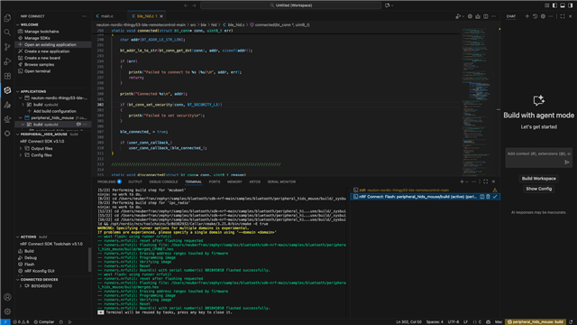

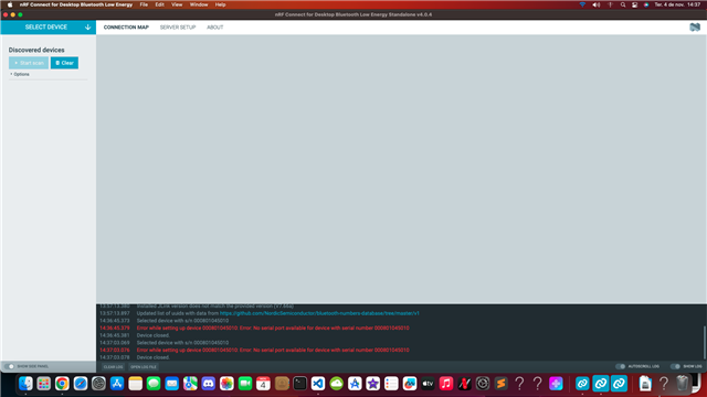

I've been trying this project for 3 days. I can compile, make changes to capture data and/or return to the inference. This is on Ubuntu 22.04 or Windows 11 (always using an Orico BT-403 Bluetooth 4.0 dongle).
However, my computers are macOS Big Sur and macOS Ventura. On the first one, I was only able to connect once (Host/MacOS-Computer <--> Thingy53 with Bluetooth).
I'm writing to ask what changes I need to make to the neuton-nordic-thingy53-ble-remotecontrol project (probably in the file below) to resolve my Bluetooth connection problem on my Mac OS Ventura.

  • I build and flash peripheral_hids_mouse in my hackintosh/Mac-Intel/MacOS Ventura and not appear in bluetooth devices. How to use it?
    Note.: My nordic device here is thingy53 in moment. But I have nrf7002DK and nrf54l15 too
    Note 2: My bluetooth in Ventura is Ok. Look my headphone name siidoo
    Note 3.:
    Note 4.: I can access NCS HIDS mouse app in thingy53 from Windows 11 with Orico bt-403 dongle bluetooth But I can't acess NCS HIDS mouse from Ventura:
