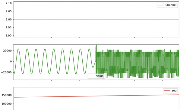

I'm trying to play a 60 Hz uncompressed PCM file from a wav embedded in flash memory.
I'm noticing some inconsistent output on I2s. I would expect similar output every time I run this.

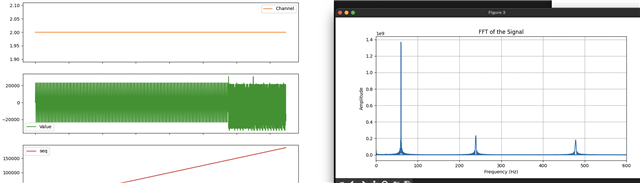

I'm using salae to capture/analyze the I2S, then a python script to plot the wave form and generate the FFT
  • sometimes playback is flawless
  • sometimes I get 1 cycle of the sine wave and then it stops
  • sometimes i get most of the sine wave perfect, followed by nonsense.
When the waveform is clean, I get a perfect FFT with a peak at 60 Hz.
When the waveform isn't perfect, it looks like this
Here is where it goes from good to bad

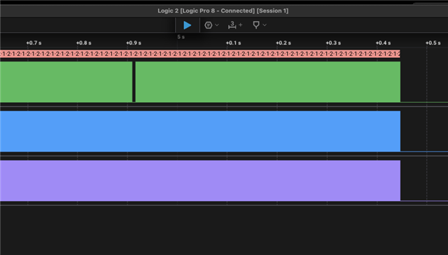

Also noticing a clear gap in the data

2- I occasionally see the following error, does that mean I should retry that block? If so - immediate or next timer?
For the following waveform, I see 3 of these-
<err> audio: i2s_write: error fffffff5
On clean wave forms, I do not see this error.

  • No encoding of the audio or anything like that? From the figure it seems like there are significant harmonics at 240 Hz and 480 Hz - they should not be there.
    And sine wave seems to go from OK to something weird. No idea whether his capturing method is sound, but assuming it is something seems certainly seems wrong.
    Since you get an error message on the i2s write the first thing to do should be to 1) find out what that error code means and 2) when and why it is triggered. This should be possible to divine from the documentation or the source, either in Zephyr or ZMK.
    As I do not have any knowledge how this is handled through ZMK, I would recommend looking at the i2s driver e.g. https://github.com/zephyrproject-rtos/zephyr/blob/v3.5-branch/include/zephyr/drivers/i2s.h#L451-L484

  • Using our documentation search engine Kapa.AI:
    What does i2s_write: error fffffff5 mean?
    The error code ffffffF5 returned by i2s_write corresponds to -11 in decimal, which is -EAGAIN (Try Again) in standard error codes. This typically means that the I2S TX queue is full and cannot accept more data at the moment, so you need to try writing again later. This is confirmed in Nordic DevZone discussions, where users encounter -11 when attempting to write to I2S without properly managing the buffer or trigger sequence, especially in continuous streaming scenarios. To avoid this, ensure you are supplying buffers on time and managing the I2S state machine correctly, such as by filling the TX queue before starting and not stopping/starting the stream unnecessarily between writes see discussionsee also.
    If you see this error, you may need to:
    • Ensure you are not calling i2s_write too quickly or too slowly.
    • Make sure the TX queue is not full before writing.
    • Consider using i2s_buf_write if you are using Zephyr's newer APIs, as it may handle buffer management more robustly in some cases.
    For more details on error codes, you can check Zephyr's errno.h as referenced in the DevZone discussion.
    I hope this gives more light on the issue to find a solution.
  • I think it was counting/indexing errors. but this was helpful !
